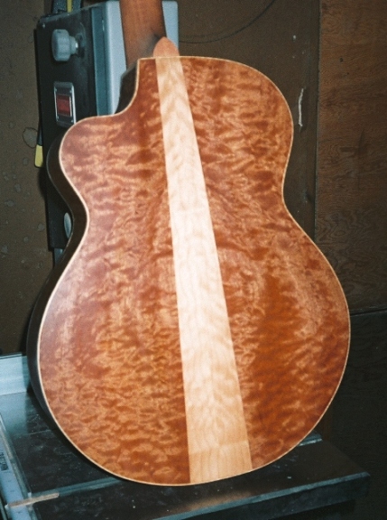

PostPosted: Mon May 08, 2006 10:04 am
Beautiful guitar James. Sapele is a very good tonewood.
Good to see you drop buy once in a while.
PostPosted: Mon May 08, 2006 10:56 am
Drool...
....and that from a guy who isn't all that jacked about bursts...
PostPosted: Mon May 08, 2006 1:35 pm
I like that burst!
